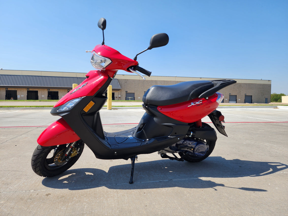

Scooters we stock
Most of the advice here is aimed at the GY6 engines used across our 150cc scooters.
